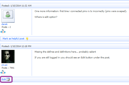

‎2014-01-10 2:32 AM
One more information: first time i connected pins rx tx incorrectly (pins were swaped).
Where is edit option?- Mark as New
‎2014-01-10 3:18 AM
Missing the defines and definitions here... probably salient
If you are still logged in you should see an Edit button under the post.Up vote any posts that you find helpful, it shows what's working..
