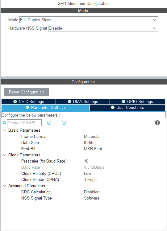

I'm trying to set up SPI communication between an MCU as master and the STM32 as slave. Data reception in the STM32 works fine, but I'm not being able to transmit data to the MCU from the STM32. I'm using the interrupt callback to read and send the data as follows:

Is there an explanation to this behavior? the SPI configuration is as follows:

‎2022-02-08 10:53 AM
> HAL_SPI_Receive_IT(&hspi1, rxbyte, 1);
> HAL_SPI_Transmit_IT(&hspi1, txbyte, 1);
SPI is not asynchronous TX/RX. Either you transmit, receive, or do both, but you can't have an RX transaction going and then try to start a TX one.
You may want HAL_SPI_TransmitReceive_IT.
