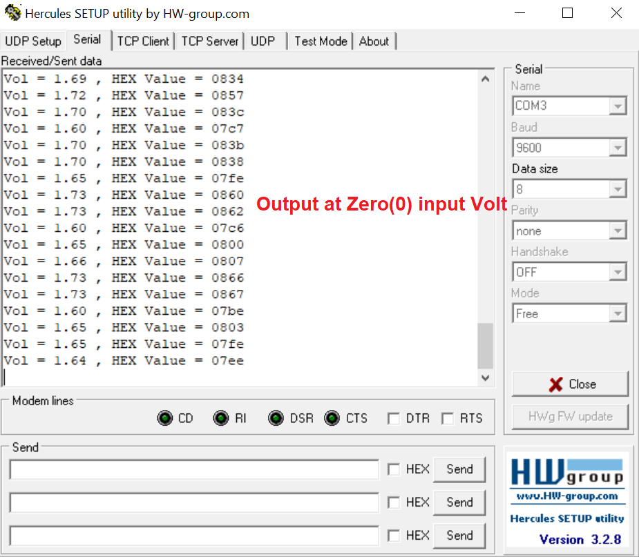

I am trying to create ADC using STM32F103C8. Software i am using are:

i am getting a constant DC Output of around 1.69 Volt, when input volt at ADC is Zero (Screen Shot attached). After supplying any Voltage value between 0 - 3.3 Volt, output is varying contentiously between 0 to 3.3 Volt.
I have checked the input reference volt, it is 3.3 Volt. Can you suggest me how to resolve this issue. I have printed a HEX value of output of function HAL_ADC_GetValue(&hadc1).
I guess, you've left the input floating (unconnected) - ADC output is then undefined.
Zero input means, that the input is connected to ground.

‎2021-07-19 4:57 AM
Thanks for the Reply. Your suggestion work perfectly.
