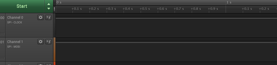

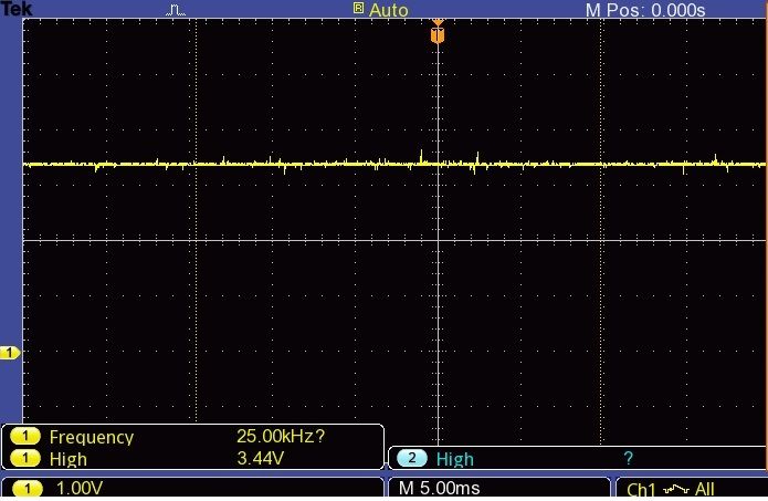

dimacalugari
Posted on September 14, 2015 at 06:53
Dear Mayla,
I've tried so and so, before and after this line, and everytime i have this picture on the SCK line:
dimacalugari
Posted on September 14, 2015 at 07:23
... and i have connected the lines to the logic analyser, and it looks so:
(I am sending the 0xAA byte in cycle)
stm32forum
Posted on September 15, 2015 at 11:36
What version of std are you using?
Try those pins as output and just toggle them to see on the scoop if the hw is ok.
