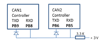

I'm trying to initialize CAN interface using two NUCLEO 64 boards. At first i only want to send and receive any message from one board to the other one. While im pushing user button (PC13), the HAL_CAN_Transmit function is called and LED (PA5) on the other board should blink. I debugged it and the variable xis incrementing well, but the LED's aren't blinking. I'm not sure if problem is no receiving, no transmitting, or both of them. I used STM32CubeMX to generate the configuration code and i'm working on STM32 AC6. Code from main.c file:

I connected the Tx output from one board to Rx of another, with 1N4148 diode. Could someone tell me where the problem is? Regards. #can #stm32f103 #nucleo

You're not looking for message ID ZERO
CAN_FILTERMODE_IDMASK not CAN_FILTERMODE_IDLIST
You'd need to connect the bus in a manner that a receiving device could acknowledge.

Thank You for reply.
I changed the CAN_FILTERMODE_IDLIST for CAN_FILTERMODE_IDMASK and connected it by that scheme, but it still doesn't work.

I found a solution but i forgot to reply before.
The CAN interrupt should be activated, so i added this line:
HAL_NVIC_EnableIRQ(CAN1_RX0_IRQn);
