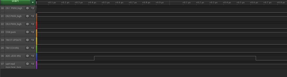

My ''without USART''  ADC interrupt handler.... looks like this ,   on the logic analyzer judging by the gpio toogle time, this routine runtime takes arround 1us to run.

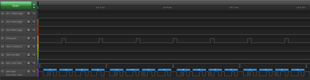

But the problem which occures is the increase of adc irq handler runtime from 1us to 100us which is huge
.... and its screwing up my pwm signals ( see screenshot bellow)0690X00000606DuQAI.png

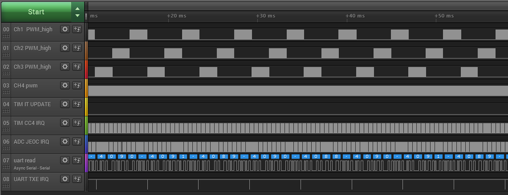

What do you think of the aproach bellow? ( also listed a logic analyze trace)
TXE IRQ  sets a flag when the data can be sent via USART from main program execution & disables TXE IRQ
After the data is sent,  the TXE IRQ is re-enabled again
