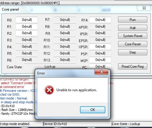

Hi, I have problem with my stm32f103, I use a st-link utility and I cant send program. When I try erase sectors I get error ''
Verify the memory protection.

23:37:53 : [fibon.bin] opened successfully.
23:38:14 : Memory-Loader error
23:38:14 : Error occured during erase operation!
23:38:15 : Programming error @ 0x200008F4!

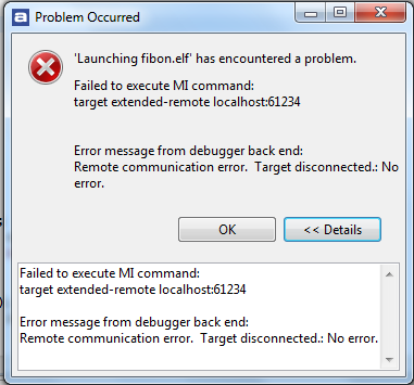

Another error from true studio.

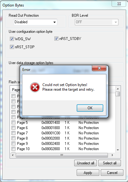

There is an odd pattern going on there.
In the ST-LINK Utilities try to look at Target->Option Bytes, and Target->Chip Erase Consider also downgrading the ST-LINK firmware, some people have encountered issue with V19, you could try V16 or V17?Up vote any posts that you find helpful, it shows what's working..
‎2014-03-31 11:11 PM
I can erase chip but I cant erase sectors... I also have error in the other ide, truestudio. Where I may download v16 or v17?
‎2014-04-01 8:17 AM
Yeah, really can't help you with Atollic/TrueStudio, not my thing.

Hi
Atollic does not deal with the options bytes. If the Flash sector lock bits have been set - Atollic cannot download. You have to use the ST-Link Util to change the option bytes bits. Hope that helps- Mark as New
‎2014-04-01 9:31 AM
When I try set Option bytes I get error. Any ideas what is wrong?
‎2014-04-01 10:41 AM
Perhaps there are other issues with your system/installation? Drivers, software, OS? Try with current drivers/software directly from ST, rather than random stuff supplied by Atollic. Try a different system.Up vote any posts that you find helpful, it shows what's working..

Something is odd here! Does the program put the processor into any of the low power modes? (I noticed in the list output - the debugger mentions that debug in sleep mode enabled) Have the SWD pins been used for IO or a peripheral?- Mark as New
‎2014-04-02 2:14 AM
I never use SWD pins. I can put program into processor in other low power modes but only stm32f10xLoader.bin.
When I put program into stm32f3 (processor in discovery board) all it's OK.
