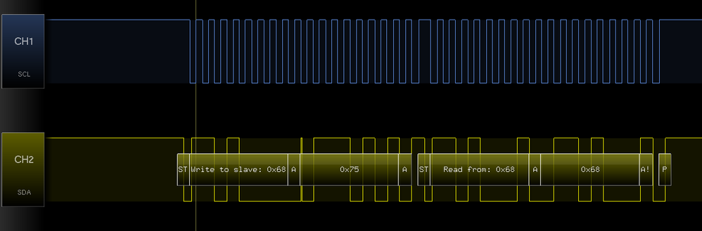

What am i doing wrong? :) Thank you in advance Krzysiek PS This is i2c transfer, and it looks quite good 0690X000006052BQAQ.png #i2c #stm32-irq-i2c-problem #i2c

Problem solved, i forgot to enable buf interrupt in cr2. Now i need to play with irq routine to limit nubers of interrupts....
