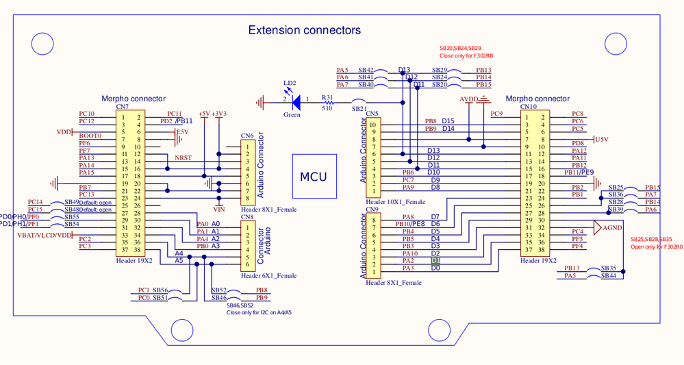

STM32F091RC DAC PINA4 PINA5 not working
roboticsdev
I have been following mastering stm32 book for a while now and checking out the tutorials from the st channel.
I was following the dac tutorial and I had a problem with outputting analog signals in pin A4.
I use eclipse IDE and i am imporing cube-mx files to the default stm project created in eclipse with a tool called CubeMXImporter.
So far, i didn't have any problem with the tool so I really don't know the reason.
my main.c file and hal_msp file is attached below if you would like to take a look.

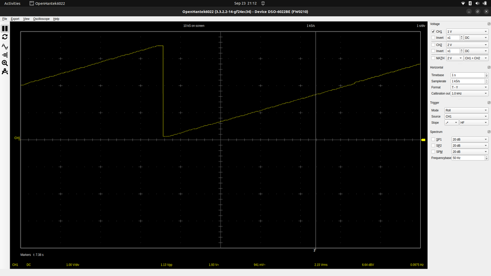

Well, turns out that PA5 is actually connected to PD13 and the signal is outputted in that pin. But I really don't know why PA5 pin doesn't show it up.

Hello, thanks for the help really, i really don't know the reason, but PA2 pin show the output in DAC and not PA5 , I really don't know why.
does this output mean that i have a problem with my board ? because PA5 and PA2 are not connected in any way from the schematics.
