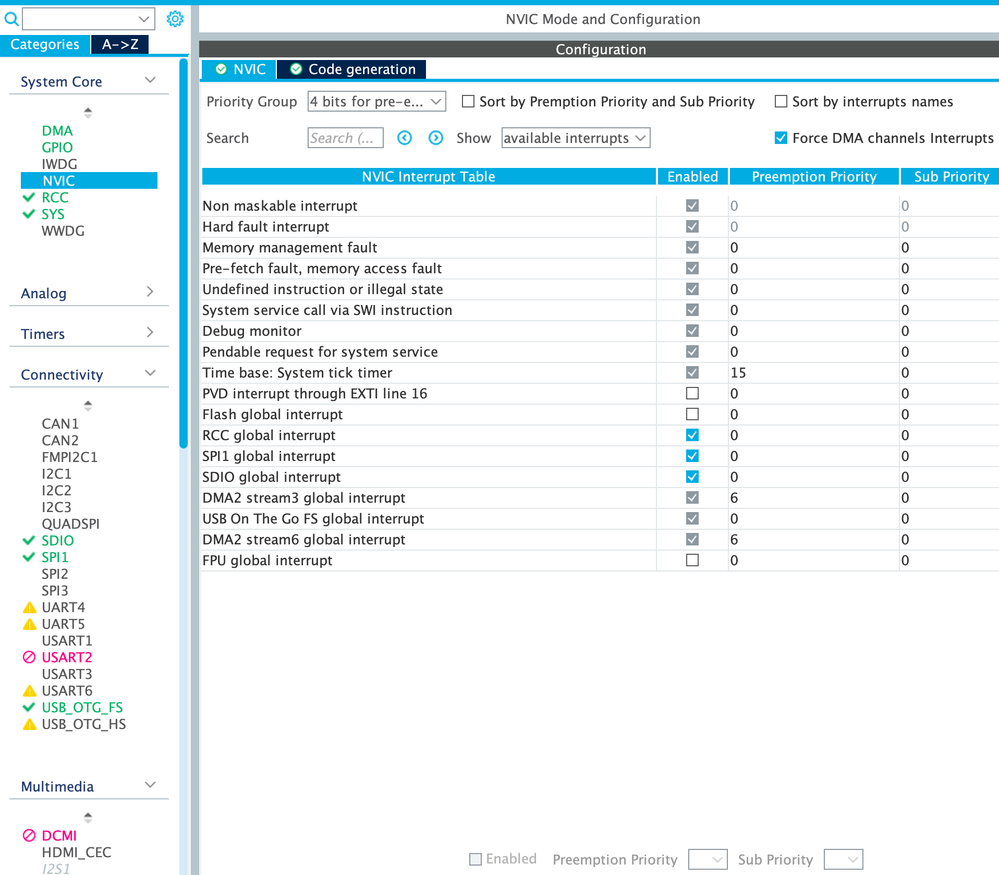

In the STM32F4 example, the HAL_MMC_RxCpltCallback  function is called to clear the readstatus flag. However, in my code the HAL_MMC_RxCpltCallback is never called and thus gets stuck in the while loop shown in the first code block.
If I remove the while loop altogether, then the code actually does enter in the HAL_MMC_RxCpltCallback as expected and clears the flag. So is the while loop blocking it somehow?

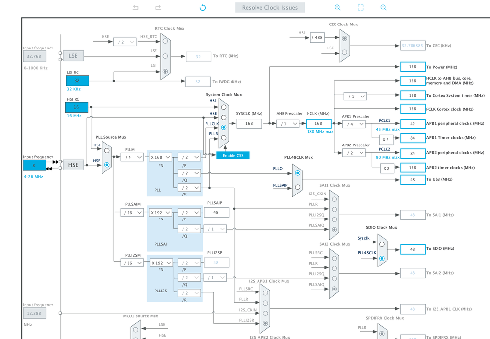

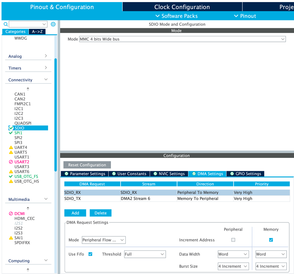

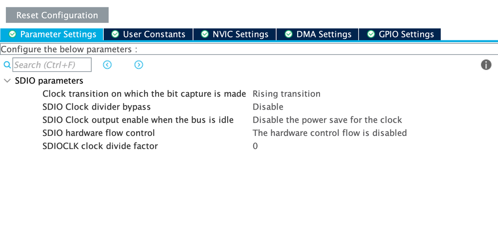

Here's my interrupt, DMA, and clock settings:
Screenshot 2023-09-23 at 1.40.44 PM.pngScreenshot 2023-09-23 at 1.40.59 PM.pngScreenshot 2023-09-23 at 1.41.16 PM.pngScreenshot 2023-09-23 at 1.41.25 PM.png
