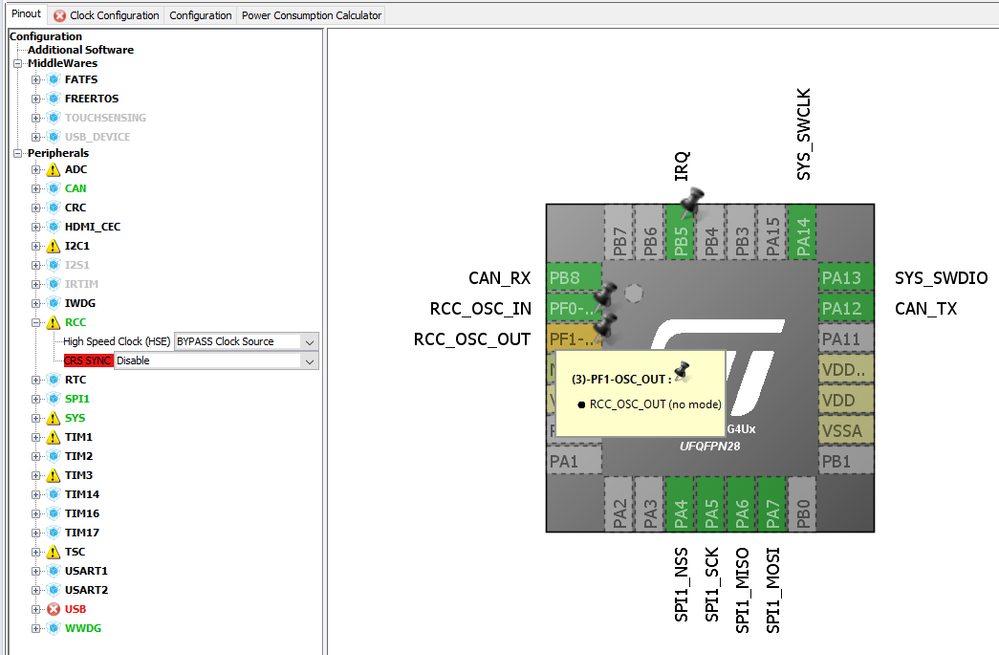

As described before (https://community.st.com/s/question/0D50X00009sWdDqSAK/stm32f042-bootloader-activation) I want to use 2 STM32F042 as CAN controller. So far I planned to use the internal HSI RC oscillator, but a +-5% tolerance seems critical for CAN clock accuracy. Using a crystal is not possible due to size and cost limitations.
I can create a 8Mhz signal from host CPU and use this as system clock. I would even like to use clock output of one STM32 as clock input of the other to avoid having my host CPU need to drive both inputs.

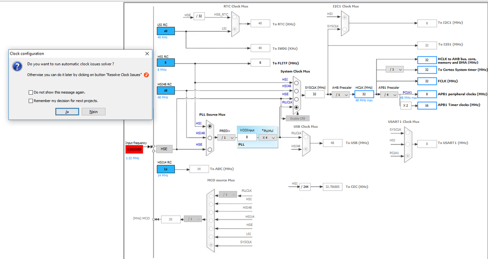

Is that possible? How do I configure this? When trying to enter this in CubeMX, I get errors: When entering "8" in Input frequency it is getting overwritten with 0.0000080, when writing 8000000 I can't leave the clock fonfiguration tab.
In neither cases I can select a clock output.
Any recommendations?
Thanks, Harald

in the cube,
On the "pin out" tab, what options for Osc ? select crystal, take 8Mhz to input,
From the output, use resistor to cascade the output off to the next processor... very dodgy, noisy (radiating) and you will have spurious clock moments "spikes affecting you" which may or may not satisfy the clock requirements of this and the next processor...

You could distributed a lower speed clock and use the CRS function to synchronize the on board oscillator. I use CRS for USB clock generation, but it also can take the CRS_SYNC signal from some of the GPIO pins.
