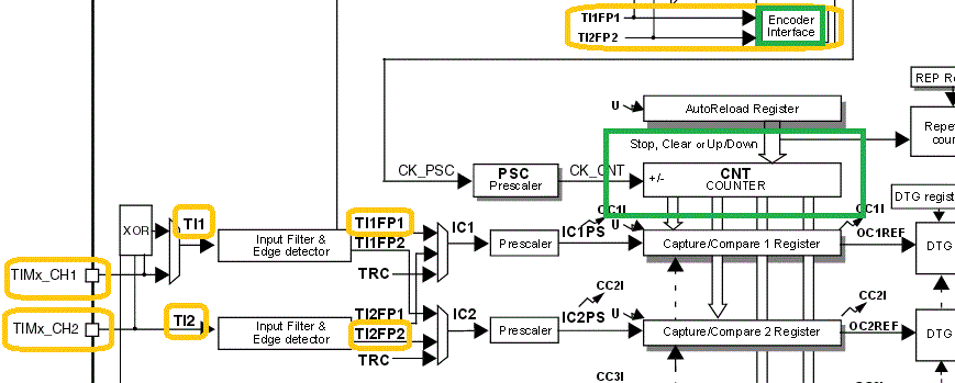

Look, you have to use channels 1 & 2 of the timer for encoder mode.
PB1 -> TIM3_CH4 not going to work PB5 -> TIM3_CH2 will complement PA6 TIM3_CH1 or PB4 TIM3_CH1Up vote any posts that you find helpful, it shows what's working..

‎2014-12-01 12:25 PM
The pin associations can be found in the Data Sheet, Timer block diagrams, and use cases, in the Reference Manual
http://www.st.com/web/catalog/mmc/FM141/SC1169/SS1574/LN1826/PF258968
http://www.st.com/st-web-ui/static/active/en/resource/technical/document/datasheet/DM00088500.pdf

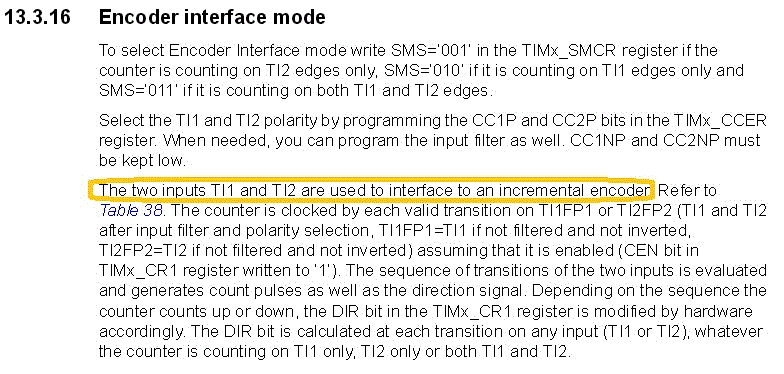

Thank you clive1
I think you got me wrong, I know how to find the pin associations. But I did not find the information for it's working only on CH1 & CH2 of the timer. Can you help me?- Mark as New
‎2014-12-01 4:13 PM
Ok, let me go dig that up.
In the mean time here is the library source, and your options to use TI1 and TI2 nodes./**
