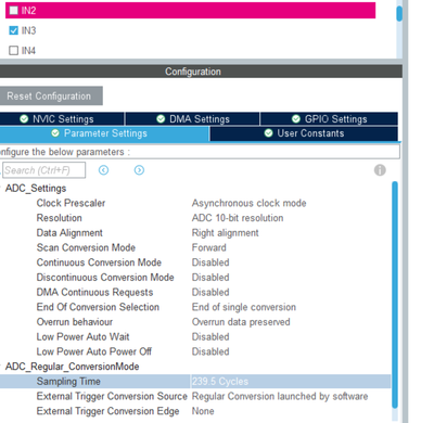

I have an ADC issue with the STM32F0. Looked all through the HAL docs and not sure what the error is. I can't get the ADC to complete a conversion or if it does only the first call. When I debug with the ADC calibration call, it goes to a fault. When I try sampling it with polling it doesn't update (I'm guessing because the conversion never completes). If I start it with the interrupt call, it never services the interrupt because I'm guessing the conversion never completes.
Everything was setup in CubeMX as below
My attempt to get the ADC value (also not sure if I should be calling to handle &hadc3, but result is the same with no ADC value)

Thank you Pierre,
the ADC calibration call (when used) enters some failure leading to a WHILE(1) loop in the HAL library, so there is likely a related issue.
ADC initialization code is below from the cube generated content, &hadc1 or 3 handle is declared in my globals:
ADC_HandleTypeDef hadc1;
Initialization code:
static void MX_ADC_Init(void)

/** Configure the global features of the ADC (Clock, Resolution, Data Alignment and number of conversion)
hadc.Instance = ADC1;
hadc.Init.ClockPrescaler = ADC_CLOCK_ASYNC_DIV1;
hadc.Init.Resolution = ADC_RESOLUTION_10B;
hadc.Init.DataAlign = ADC_DATAALIGN_RIGHT;
hadc.Init.ScanConvMode = ADC_SCAN_DIRECTION_FORWARD;
hadc.Init.EOCSelection = ADC_EOC_SINGLE_CONV;
hadc.Init.LowPowerAutoWait = DISABLE;
hadc.Init.LowPowerAutoPowerOff = DISABLE;
hadc.Init.ContinuousConvMode = DISABLE;
hadc.Init.DiscontinuousConvMode = DISABLE;
hadc.Init.ExternalTrigConv = ADC_SOFTWARE_START;
hadc.Init.ExternalTrigConvEdge = ADC_EXTERNALTRIGCONVEDGE_NONE;
hadc.Init.DMAContinuousRequests = DISABLE;
hadc.Init.Overrun = ADC_OVR_DATA_PRESERVED;
if (HAL_ADC_Init(&hadc) != HAL_OK)
Error_Handler();
/** Configure for the selected ADC regular channel to be converted.
sConfig.Channel = ADC_CHANNEL_3;
sConfig.Rank = ADC_RANK_CHANNEL_NUMBER;
sConfig.SamplingTime = ADC_SAMPLETIME_239CYCLES_5;
if (HAL_ADC_ConfigChannel(&hadc, &sConfig) != HAL_OK)
Error_Handler();

  • You should enable Continuous mode by changing "hadc.Init.ContinuousConvMode = ENABLE;" to automatically restart conversion after each one.
  • Can you specified which failure ? Have you configure the ADC before calibration ?
