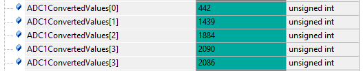

Essentially I have 4 ADC's (in 12 bit resolution mode) and I am trying capture that data and convert it (ie temp, moisture, ect..). Trying to understand how the API works for the DMA conversion and how my 4 ADC channels align in my assigned pointer. Below outlines what I currently have set up, and highlighted in red text is where my confusion is.

Debugger Watch result:

Jinhui Lin
Posted on April 15, 2017 at 15:30
if (HAL_ADC_Start_DMA(&hadc, (uint32_t*)ADC1ConvertedValues,
1024
) != HAL_OK);
1024 is not correct, it should be 4 for you, I think.

Read 4-ADC-Channel to memnory
static uint16_t adc_buffer[4];
hadc1.Init.NbrOfConversion == 4
if(HAL_ADC_Start_DMA(&hadc1, (uint32_t*)&adc_buffer, hadc1.Init.NbrOfConversion) != HAL_OK);
HAL_Delay(500);
HAL_ADC_Stop_DMA(&hadc1);
