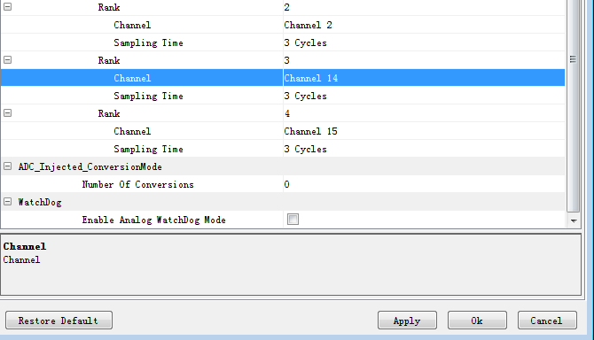

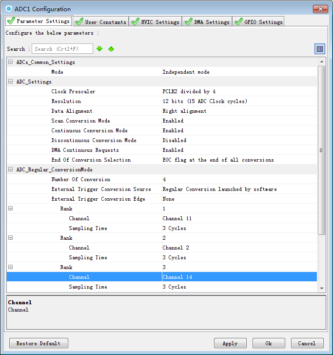

‎2017-04-15 3:54 AM
Posted on April 15, 2017 at 12:54
Use DMA Mode to read multi-channel-adc looks fine,
for example
PC1 ------> ADC1_IN11,
PC4 ------> ADC1_IN14,
PA2 ------> ADC1_IN2,
PC5 ------> ADC1_IN15:
1. ADC Initial : for channel with 4 different rank
/* ADC1 init function */
static void MX_ADC1_Init(void)
ADC_ChannelConfTypeDef sConfig;
/**Configure the global features of the ADC (Clock, Resolution, Data Alignment and number of conversion)
hadc1.Instance = ADC1;
hadc1.Init.ClockPrescaler = ADC_CLOCK_SYNC_PCLK_DIV4;
hadc1.Init.Resolution = ADC_RESOLUTION_12B;
hadc1.Init.ScanConvMode = ENABLE;
hadc1.Init.ContinuousConvMode = ENABLE;
hadc1.Init.DiscontinuousConvMode = DISABLE;
hadc1.Init.ExternalTrigConvEdge = ADC_EXTERNALTRIGCONVEDGE_NONE;
hadc1.Init.ExternalTrigConv = ADC_SOFTWARE_START;
hadc1.Init.DataAlign = ADC_DATAALIGN_RIGHT;
hadc1.Init.NbrOfConversion = 4;
hadc1.Init.DMAContinuousRequests = ENABLE;
hadc1.Init.EOCSelection = ADC_EOC_SEQ_CONV;
if (HAL_ADC_Init(&hadc1) != HAL_OK)
Error_Handler();
/**Configure for the selected ADC regular channel its corresponding rank in the sequencer and its sample time.
sConfig.Channel = ADC_CHANNEL_11;
sConfig.Rank = 1;
sConfig.SamplingTime = ADC_SAMPLETIME_3CYCLES;
if (HAL_ADC_ConfigChannel(&hadc1, &sConfig) != HAL_OK)
Error_Handler();
sConfig.Channel = ADC_CHANNEL_2;
sConfig.Rank = 2;
Error_Handler();
sConfig.Channel = ADC_CHANNEL_14;
sConfig.Rank = 3;
Error_Handler();
sConfig.Channel = ADC_CHANNEL_15;
sConfig.Rank = 4;
Error_Handler();

4. Read Multi-ADC-Channel to memory
static uint16_t adc_buffer[4];
hadc1.Init.NbrOfConversion == 4
if(HAL_ADC_Start_DMA(&hadc1, (uint32_t*)&adc_buffer, hadc1.Init.NbrOfConversion) != HAL_OK);
HAL_Delay(500);
HAL_ADC_Stop_DMA(&hadc1);
