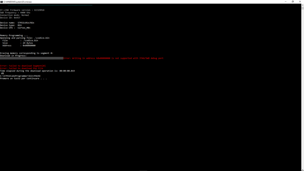

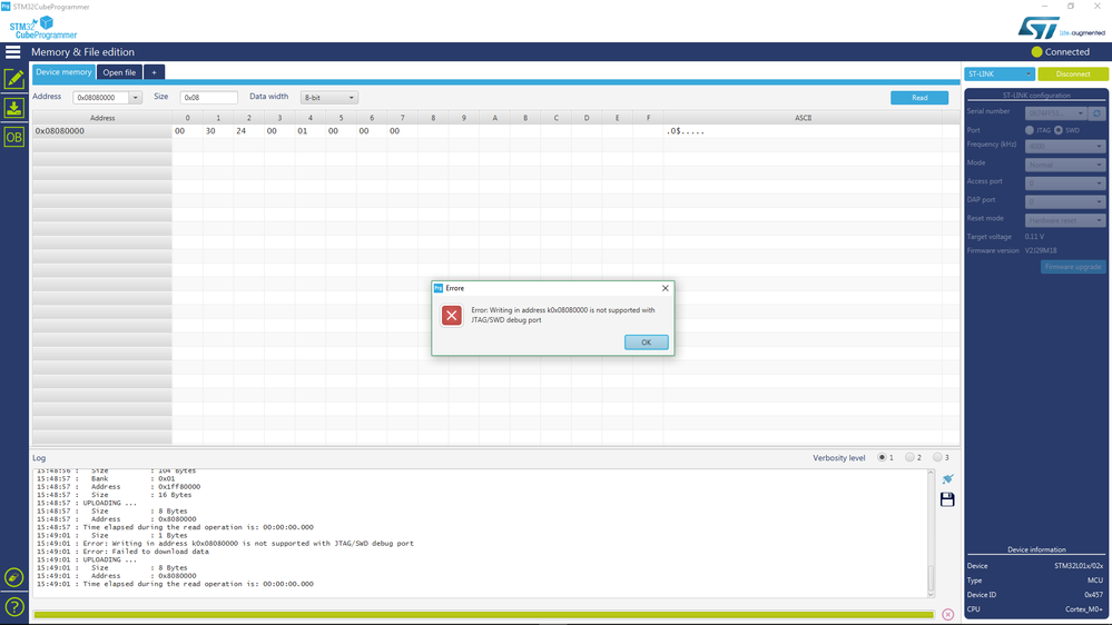

Hi, I have a micro STM32F011F4 and I try to write in EEPROM via
SWD but cube programmer shows an error message (also from CLI)
how can I write in EEPROM? (STM32 STlink utility works well)
Thank you
Marco

Programming STM32L0/L1 internal EEPROM is not yet supported by STM32CubeProgrammer, only Internal flash is managed. This feature will be added in coming releases.
