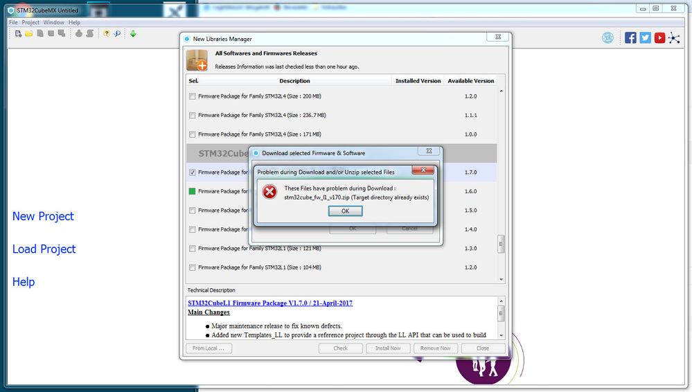

I get an error each time I attempt to install the library ''Firmware Package for Family STM32F7'' into STM32Cube MX.  This occurs after removing the original Zip files and uninstalling reinstalling STM32CubeMX.
The stm32cube_fw_f4_v1130.zip installs without issues.
The failed install sequence is shown below is shown in the attached screenshots file.
The Firmware Packet for Family STM32F7 (V1.51)  is selected.  Note Installed version is blank.
The install now button is clicked and then the second and third error dialogs occur.
The error message contains. ''These Files have problem during Download: stm32cube_fw_f7_v151.zip (Target directory already exists).
When process is complete, Firmware Packet for Family STM32F7 is shown as not installed.  The 1.5.1 is the available version.  The installed version field is blank.

I had a similar issue recently. I believe that in fact there is an issue with the 1.51 package.
I had downloaded separatly the 1.50 package from the ST website.
In CubeMX, there is an option to install from local files (in Help > Install new Libraries).
I could install the package that way.

I have successfully download and install this package without problem! Maybe in your case a server is down for few minutes.
So, in this case you should remove the installed file and try again the download:
Try close CubeMx -> reopen  -> click in check update -> download again.

Posted on July 15, 2017 at 14:04
