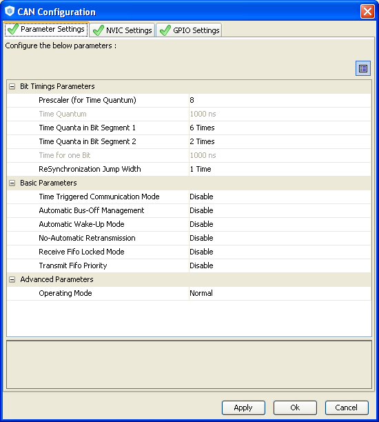

STM32CubeMX 4.6.0, STM32F103C8T6
Configurator for
CAN
controller
doesn't change value for Time Quantum and
Time for one Bit. It
shows
always
1000 ns.

Posted on March 18, 2015 at 10:40
This will be fixed with STM32CubeMX 4.7.
Best regards.

Posted on March 19, 2015 at 23:59
Hello STM32Cube-T,
please fix also together
inaccuracy
in
calculating
of time for one bit. See
