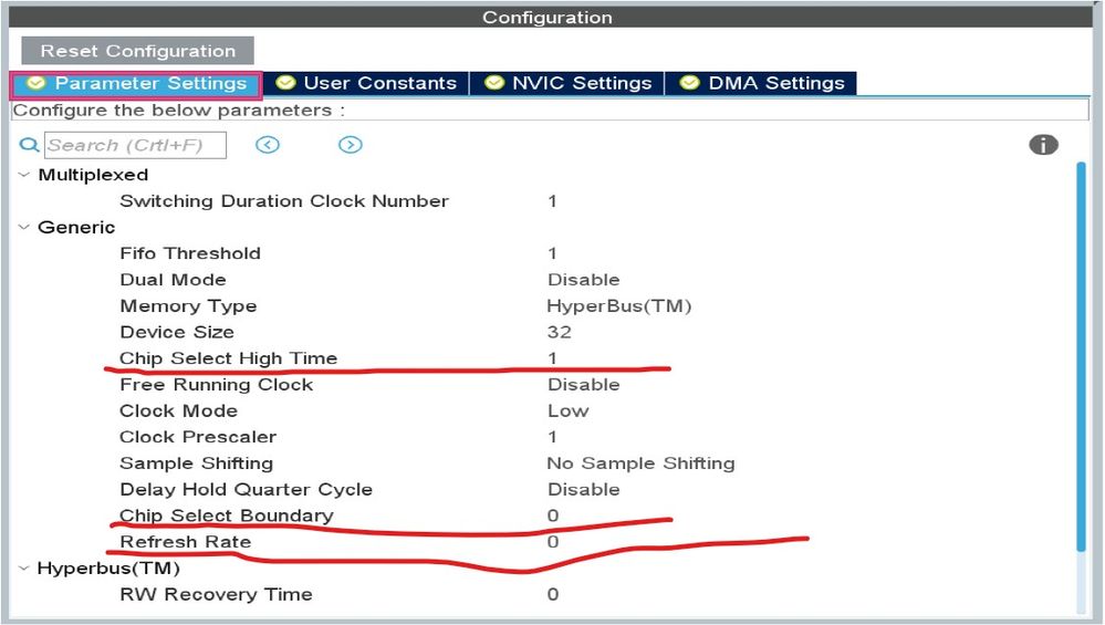

STM32CubeMX - OCTOSPI configuration
rsun.11
When I used STM32CubeMX to do the parameter setting. For some of the parameters I don't know how to configure them. For example, the parameters like: "Chip select high time", "Chip select boundary", "Refresh rate". How to configure the above three parameters in combination with the datasheet?
ChahinezC
Lead
Hello @rsun.1​,
I recommend you checking the "Table 5. STM32CubeMX - Configuration of OCTOSPI parameters" of the AN5050, it will help you.
