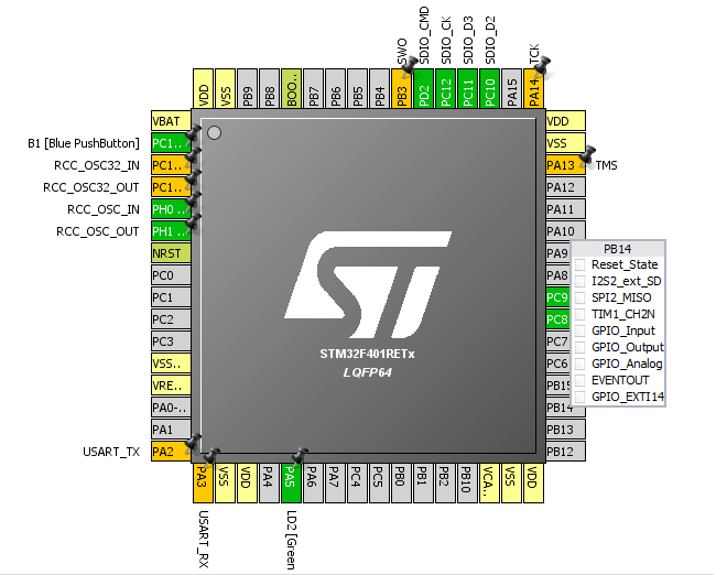

Everyone,
How can I use cubeMX for SDcard ? I have generated for MDK but :
this function doesn't work , from UM1721
User manual
Developing Applications on STM32Cube with FatFs page 21.
uint32_t wbytes; /* File write counts */
uint8_t wtext[] = 'text to write logical disk'; /* File write buffer */
if(FATFS_LinkDriver(&mynewdisk_Driver, mynewdiskPath) == 0)
if(f_mount(&mynewdiskFatFs, (TCHAR const*)mynewdiskPath, 0) == FR_OK)
if(f_open(&MyFile, 'STM32.TXT', FA_CREATE_ALWAYS | FA_WRITE) == FR_OK)
if(f_write(&MyFile, wtext, sizeof(wtext), (void *)&wbytes) == FR_OK);
f_close(&MyFile);
FATFS_UnLinkDriver(mynewdiskPath);
This variable :
&mynewdisk_Driver doesn't exist, which file is related ?
Thank you
