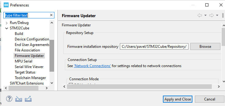

Please open Window->Preferences and then open the repository folder in Explorer
0693W00000GZYzgQAH.pngDo you see there subdirectory named STM32Cube_FW_H4_V1.26.0 or STM32Cube_FW_H4_V1.26.2 ?

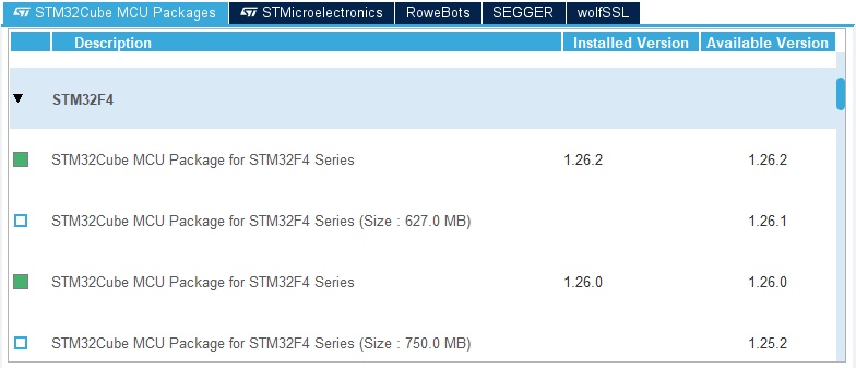

  • I have the package installed (manually by downloading the zip file on the product page) then by using the "From local..." button in the embedded packages manager. This gives me the following :0693W00000GZb9OQAT.png

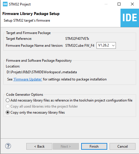

  • But when I try to create a new project :

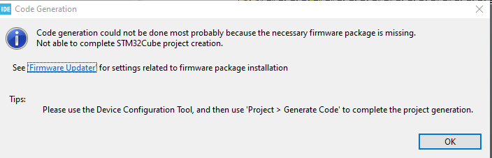

  • I always get this error : 0693W00000GZbAgQAL.png
