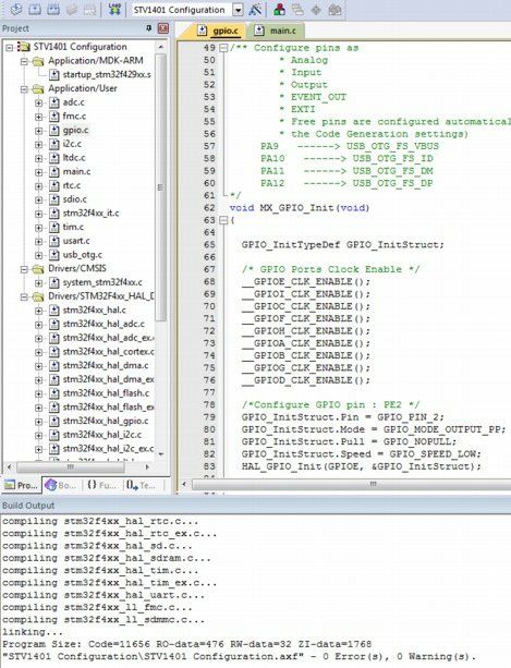

Using the brand new CubeMx version (4.2, released two days ago), I took the .ioc file, generated code for Keil 4.73: no issue in Keil, link with no errors, and the gpio.c file clearly present in the project.
Maybe it is worth trying with Mx 4.2 (I do not have any more 4.1, then can not reproduce initial problem). Rgds.- Mark as New

I too am seeing issues with the generation of gpio.c using v4.2. I also have setup for seperate .c and .h. When I generated the files initially the gpio.c file was generated but afterwards when I make changes to the project in CubeMX and regenerate the files the gpio.c file is removed from the project....this is a real nuisance that I haven't been able to resolve.
The workaround mentioned above may work but is a real inconvenience.- Mark as New

I have this problem too, with a missing gpio.c file. However, I have found that the file is actually created, in the beginning of the generation process, but after some seconds it will be deleted again. Using my software editor, in file-open-mode, I manage to catch the gpio.c file when it gets created, and then I can save it again after the original file has been deleted by STM32Cube. Annoying but still a workaround. If I don't make any changes that affects the gpio.c file, I can just save a copy of the first file with a different name, and then copy that into the gpio.c after a new code generation run.

just to add to the list -- I've encountered the same issue. Create a new project, select ''Generate peripheral initialization as a pair of .c/.h files per IP'' in the settings, enable some random GPIO, then click on ''Generate Code''. In the first run gpio.c will be generated just fine. Now close STM32CubeMX, and restart it by double-clicking the respective *.ioc file. Click on ''Generate Code'' again. The gpio.c files is now gone. I currently use STM32CubeMX 4.2.0.
