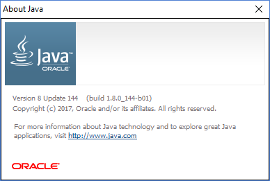

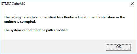

I just installed STM32CubeMX on my Windows 10 machine. When I try and launch it, I get the following error. How can I fix this? I have Java installed- for many environments and the Java About returns the message below
‎2017-09-25 1:19 PM
>> How can I fix this?
Go into the registry and find the node that points to a deleted/replaced version of Java. Then delete that node.
http://www.google.com/search?q=java+registry+cleanup
‎2017-09-25 4:11 PM
I tried that but I still get the same message. Any chance you could tell
me which registry entry it is looking at?

I'm sure it is enumerating through them, so machine specific.
I've seen JRE updates do a clean-up. Might want to double check for 'Installed Programs', making sure there aren't assorted versions.
https://www.java.com/en/download/faq/remove_olderversions.xml
ST might be able to provide specifics of what they enumerate, or be able to provide additional diagnostic output, I am not ST.
Check also if anything is listed in the PATH environment variable. Open a DOS Box, type PATH
