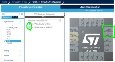

Remapping PA9/PA10 on PA11/PA12 does exactly that--it physically (via a switch) connects the PA9/PA10 pins to the external PA11/PA12 pin positions.
Load up CubeMX and maybe that will help with understanding.

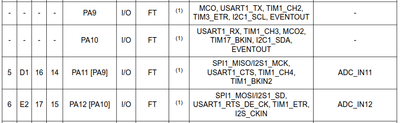

Thank you for your quick reply.
The problem is that with my package(UFQFPN20), PA9/10 are not present. As you said they are remapped on pins PA11/PA12, but on the datasheet PA11 and PA12 don't have USART1_TX and USART1_RX as you can see in the following table.
Even STM CubeMX doesn't allow me use PA11/PA12 for USART1.
So that's the source of my doubt. But if you confirm that I can indeed use PA11/PA12 as USART1 then it's perfect.

Thanks a lot, I didn't know I had to activate the remapping. Now it makes sense and I tried it and it works.
