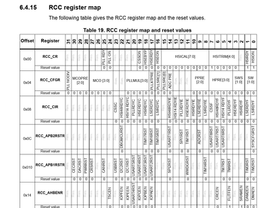

The following part seems to use pll with 8mhz input,  divided by2 and multiplied by 12, to obtain 48Mhz, but this part seems to be equivalent to the use of HSI48 to obtain the same result of a 48Mhz:
RCC->CR |= RCC_CR_HSION;
while(!(RCC->CR & RCC_CR_HSIRDY)){};
RCC->CFGR &= ~(RCC_CFGR_PLLMUL | RCC_CFGR_PLLSRC);
RCC->CFGR |= (RCC_CFGR_PLLSRC_HSI_DIV2 | PLL_MULT_X12);
/* Turn on the PLL and wait for the hardware to set the ready flag */
RCC->CR |= RCC_CR_PLLON;
while(!(RCC->CR & RCC_CR_PLLRDY)){};
For the second part it is still not clear to me how to convert it to HAL:
/* Now set the clock source of the system clock */
RCC->CFGR &= ~(RCC_CFGR_SW);
RCC->CFGR |= RCC_CFGR_SW_PLL;
while(!(RCC->CFGR & RCC_CFGR_SWS_PLL)){};
Good.
To see, what its doing, look at rm , RCC registers:
If using HSI at 48M , is same clock, but precision on crystal->HSE->PLL is better . If not needed, can use HSI also.
