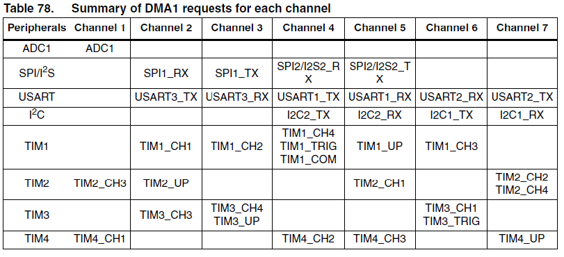

I have a problem that maybe someone can help with. I've spend the last few days on this and I just don't understand why it's not working.
I have a STM32 where I want to send out a buffer over USART 2 using DMA to a RS485 chip that sends it to a Hyperterminal via FTDI cable. I had this working using USART without DMA... by just feeding the Register with the buffer one by one. So I know that the USART and the RS485 chip works.
After inital problems i have gone to a simple example from ST Library and modified it but still can't get it to work. Here is my code.. I'm trying to continuosly send out data over USART2.
The problem: It doesn't send at all... or only once.. and usually gets stuck here:
while (DMA_GetFlagStatus(DMA1_FLAG_TC7) == RESET)
Can anyone see what I'm doing wrong?

I think it's because you need to program DMA for each transfer.
This works for USART1 on a VLDiscovery, I don't have USART2 wired up.

Thank you kind sir! You are a hero! - It works now :)
I wasted so much time on this - and i still don't understand why it's necessary to reinitialize the dma before each transmit... but it works for now.

Ok next problem...
Now I want to use the interrupt - but every time I set it up like this:
/* Enable the DMA Channel 7 Interrupt */
NVIC_InitStructure.NVIC_IRQChannel = DMA1_Channel7_IRQn;
NVIC_InitStructure.NVIC_IRQChannelPreemptionPriority = 0;
NVIC_InitStructure.NVIC_IRQChannelSubPriority = 0;
NVIC_InitStructure.NVIC_IRQChannelCmd = ENABLE;
NVIC_Init(&NVIC_InitStructure);
the program gets stuck and the Transmit Complete Flag doesen't get set anymore. Does anyone see my fault. All I want to do.. is to start sending using the DMA .. and then use the TC interrupt to toggle an output on the board. The interrupt never comes though. Here is my code:

r_s_1
Posted on December 21, 2013 at 23:47
i encountred the same problem DMA is working only with usart1 but not all channel that's why i tried all channel and it's finally working with channel6 i don't know if its a problem or a configuration range in STM
Posted on December 22, 2013 at 01:48
Something you'd expect to find in a Reference Manual?
From the STM32F1xx one
