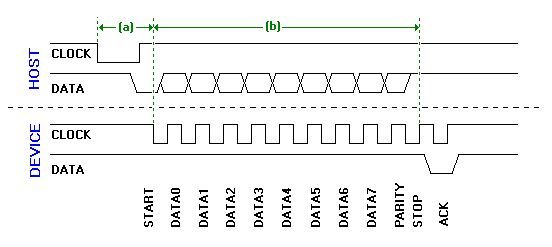

I want to connect Ps2 keyboard To STM32F103
From which protocol should I use?
Posted on February 20, 2013 at 16:17
Doesn't look compatible with any STM32 peripheral.
Bit bang, use Google?
http://hackaday.com/2010/11/08/czech-discovery-ressurects-ps2-keyboard/
