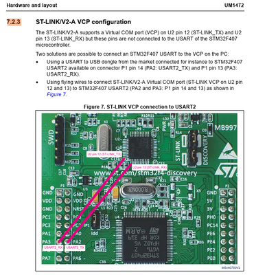

I'am new to STM32 and i want to create project that interface with user using uart with serial monitor
i  configured usart and used hal_uart tarsnmit function but it didnt work when the tutorial im following worked for him

Hello @avatar_ang  and welcome to STcommunity!
can you explain how are you trying to print your messages  in serial monitor?
in the STM32F407G-DISC1 ,the ST-Link embedded in the F407 discovery is not wired to a target MCU UART, so it has no virtual COMPORT capability.(the physical connection is missing.) you will need to add physical link wires to the Discovery board or connect to a separate USB-to-UART adaptor.
Maybe this is your issue.
It does have the VCP (Virtual COM Port) capability in the ST-Link itself - it just lacks the physical connection from the ST-Link to the F407 Target MCU

Feb 23, 2026 3:10 PM UTC
thanks for mentioning the USB to UART converter we used one and it worked
