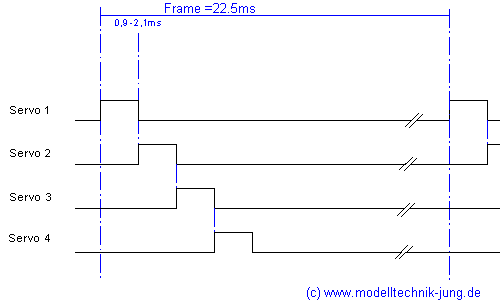

Hello Togehter,
I just make the step from AVR to powerfull STM32 and need to controll a servo. Timer for the STM32 are for me very confused, so my question, has somebody already made a servo board, like this- Mark as New
