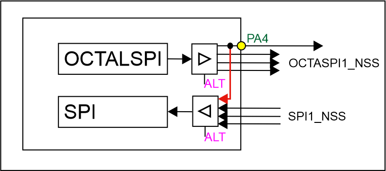

Using the STM32U5xx MCU - I see that PA4 on STM32U5A5 can be OCTOSPI1_NSS signal as well as SPI1_NSS signal.
Now, I want to use SPI1 in parallel with OCTOSPI1 (as QuadSPI). The SPI1 should be a SPI Slave Rx where OCTOSPI1 is my master QSPI Tx.
I want to know this:
- If PA4 is configured, via ALT, as OCTOSPI1_NSS (output)
- can I configure SPI1 to use HW_NSS signal (also PA4), as an input
- and the output signal on PA4 as OCTOSPI1_NSS is routed back as input to SPI1_NSS?
What I understand:
When I would configure PA4 as SPI1_NSS (via ALT) - it would become an input. OCTALSPI1_NSS would be disconnected as an output.
But what if I leave it as a OCTALSPI1_NSS but I configure SPI1 to use HW_NSS signal (but without ALT again)?
Would it be connected to the same PA4 signal, but internally, to read how OCTALSPI1_NSS is driven?
I mean: can a signal, driven as an output, still be used as an INTERNAL input (for another device)?

I mean this:
A) the input signal is taken from the pin (directly) - OK
Why it should not be possible?
It just depends from where the pinmux selects the signal (and if it would affect the DIRection when setting an ALT):
B) the input signal is taken before the GPIO cells and ALT affects also the DIRection - FAIL

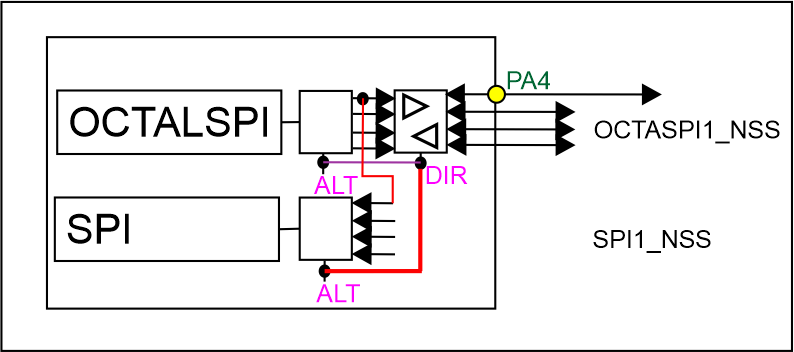

Best would be:
- If I use ALT and set as output
- but if I use ALT select as input for same pad (pin) but for other device - it should not affect the other setting: it does not change the direction of the pad (pin) - assuming (default): it is an input:
just connect the same pad (pin) as an input, never mind who is driving this signal (from internal or from external)
If the pinmux is "just" a mapping of which signal goes to which pin (pad), but the direction is not "hard-coded", it should work, to connect an input to an existing output (internally).
If any ALT config affects also the pad (pin) DIRection: sure, it fails.
(as it looks like pinmux in chip is implemented this way)
‎2024-01-20 4:26 PM
No, only one alternative function can be active at a given time.
‎2024-01-20 4:47 PM
Yes, I know (mentioned):
I was asking about: "if a signal is configured as output (via ALT), can another device still "see" the signal and read as an input?
Or this way: "is it possible, if a pin is configured as output, to read back this pin signal as an input (on any other means)?"
What happens if I enable a feature which needs an input (e.g. SPI as slave an NSS as input signal), but it is driven as an output, e.g. by OCTASPI_NSS?
Technically, this input signal can read back the INTERNAL pin signal without any ALT configured for this device pin.
I think, you are right: an input signal must be configured via ALT as input. "Assuming" it would read a signal, driven as output by another device - is not supported (even it could be, technically).
I think, chip designers could think about how a "pinmux" could work also in an alternative way, e.g.:
pinmux (ALT) selects the direction but a (default) input can be still using the same signal from a (default) pin (even driven as output). Or a secondary pinmux function: specify on which pin you want to "listen" as an input (even already in use as output).
Never mind: pretty obvious already it does not work (even it could work with a small change on pinmux: if a pin intended as input - without ALT: let is "listen" on default internal output signal).

‎2024-01-20 6:04 PM
It's a mux, only one thing can be connected at a time, regardless of input/output requirement. If it's used by OSPI, it can't be used by SPI.
Once you set a pin an AF, it is the peripheral that how to control it--whether it's an input or output. There's no separate setting for this.
