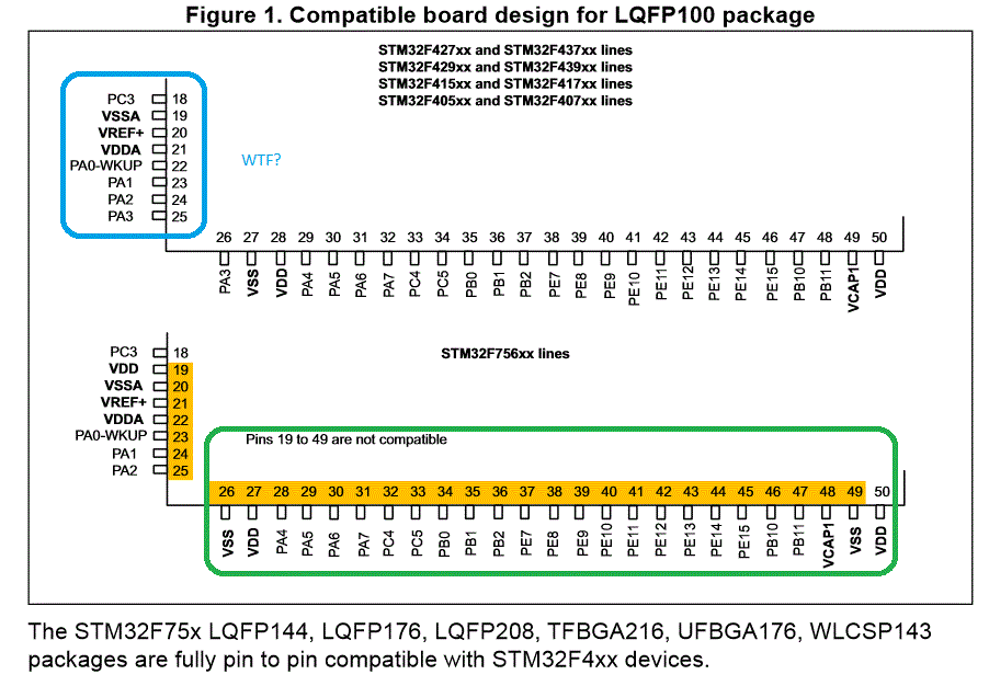

Impressive, looking forward to real silicon. Nice: - all clocks apper to be able to tick up to 200MHz - low-power timer running independently of the main clock (i.e. also in stop mode) - quad SPI Things which made me sad at the first glance: - ST chose to omit double-precision from the FPU - up to 1MB FLASH may turn out to be a severe limitation - there's a gotcha in the ''fully pin-to-pin compatibility to 'F4'': LQFP100 has a shifted row of pins Question: Will there be DISCOVERY board? If yes, will it be same or different as the existing '429/439 one? JW #whiskey-tango-foxtrot- Mark as New

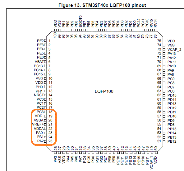

Yes, seems a little odd there isn't 1 and 2 MB out of the gate. A proper cache architecture does however suggest the SDRAM might be a viable place to unpack code, either from internal flash, serial SPI flash, or SD Card The LQFP100 stuff is just wrong. Pins 18 thru 25 aren't like the diagram onhttp://www.st.com/st-web-ui/static/active/en/resource/technical/document/data_brief/DM00116941.pdf
, and surely there was a less broken way of doing this?Up vote any posts that you find helpful, it shows what's working..

> A proper cache architecture does however suggest the SDRAM might be a viable Viable maybe, but certainly suboptimal. Not only is it inevitably slower (cache helps but is no panacea) and decreases security; it also eats the pins, which in case of applications utilizing majority of the peripherals may be an asset potentially counterweighing even a drastical price increase for the extra FLASH, or a multi-chip package (ST has or had the know-how - they used to use it in the uPSD3xxx line).> The LQFP100 stuff is just wrong. Pins 18 thru 25 aren't like the diagram on
, > and surely there was a less broken way of doing this? No wonder, once they can't draw a proper diagram... :( JW- Mark as New

Hi Clive,
This is a typo in the Figure1. But other figures are correct.It will be fixed fo the next version.With regards,Heisenberg.- Mark as New
2014-09-30 2:01 AM
So, does it mean that Fig.9 is OK, and compared to the 'F4xx, pin 19 is not VDD anymore, all pins from pin 20 to pin 49 are shifted clockwise, and pin 49 is VSS, right?
JW- Mark as New
