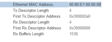

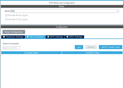

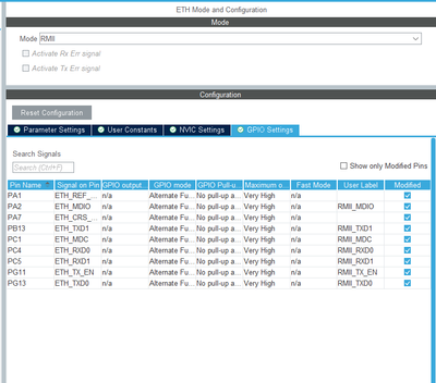

Hey all,
 I've been working on this issue for about a week and am still not gaining any traction.
I am trying to set up the RMII for the STM32H723ZG eval board (I cannot use the MII as we are using the pins for other peripherals).
The LwIP TCP echo works fine with a functioning ping yet I still have not been able to configure it correctly. Any help is greatly appreciated.
(tutorials followed at the end of the post and screen shots below.)
If that is working then your RMII (which is the hardware interface to the PHY) is set up correctly.
So what is your problem?
cjbruffAuthor
July 27, 2023
So it is working with the example, but when I follow the tutorial it does not work.
I also downloaded and built the .ioc file from the stm hotstop git hub(attached) but to no avail.
https://github.com/stm32-hotspot/STM32H7-LwIP-Examples/blob/main/STM32H723_Nucleo_ETH/STM32H723_Nucleo_ETH.ioc
Pavel A.
July 27, 2023
The last one should work. Does it ping? Could you elaborate what exactly is not good?
cjbruffAuthorBest answer
August 3, 2023

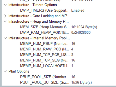

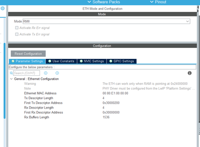

The issue was with the HEAP pointer for the LWIP.
I was assigning 0x24000000 to ETH when this address should have been used for the LWIP heap.
