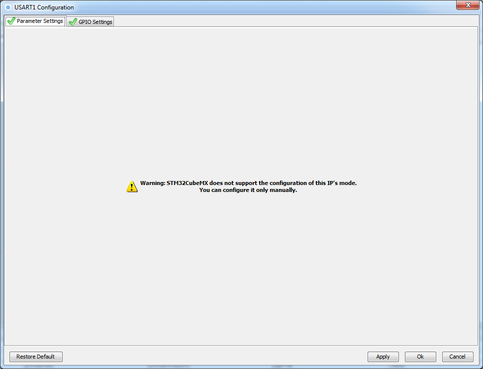

This is interesting. I did not know one could choose ''Modbus communication'' in any MCU. Also your example is the first mcu that allowed that for me, other F0's didnt have this feature. I configured it manually using async uart. I have reproduced your problem on my CubeMX. Indeed only TX pin is being configured. Additionaly, one cannot configure this peripheral:

It is not absolute necessary to set the USART as it offers a menu of the
Cube. You can combine the modern functions as you need. For example You can
use IDLE detection of Modbus with automatic DE signal by full duplex mode.
With using 3 pins connection.

Yes everything works when one sets it manually. The mxcube generator just doesnt.
Posted on January 11, 2017 at 17:53
CubeMX is a good tool, but as it is not perfect, now. I think all ahead.
