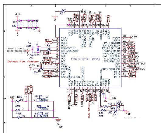

Please help checking the schematic if there is anything wrong.
As the power supply, I use RFE3033, which is capable to output 25mA current, is it enough? In the microcontroller, I use the module of I2C1,I2C3,USB, timer9,10,11, SWD debug, and the system is running at 96MHz using 16MHz internal clock(I could use external clock too). Do you think 25mA current is enough? My question is if power supply is the reason, why adding couple lines would significantly change the system? Thanks- Mark as New
‎2015-12-11 12:00 PM
I'm not sure it does, I'm trying to shot-gun a solution/causes based on very limited data. Not sure why you'd get a reset, beyond a watch-dog or external issues. Perhaps it's in the Hard Fault Handler? Perhaps you can add some more diagnostics there, or debug a bit more?Up vote any posts that you find helpful, it shows what's working..

Ok, can you step through this with a debugger? Or see where it gets stuck? Are you sure it ''resets'', can you stick a logic analyzer on NRST and capture these events?
Have you tried turning optimization off? Have you double checked the clocks the system is running from? Use the MCO (PA8) pin, review. Have you double checked the flash wait states, and cache/prefetch settings?Up vote any posts that you find helpful, it shows what's working..
‎2015-12-11 04:48 PM
Assuming the supply is browning-out, suggest you use a 2 ch scope, trigger on falling edge of NRST on first channel, with second channel attached to supply.
