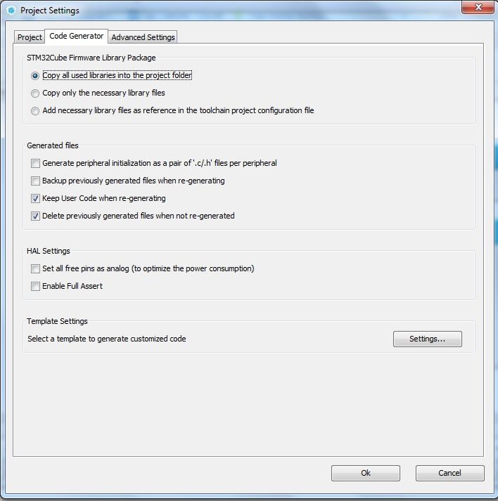

Hi Denis,
If your using CubeMX, under ''Project Setting'', select the second tab and make sure the radio button is on ''Copy all used libraries into the project folder''.
All the files for the LL Libraries are now in the [''You're Project Folder''\Drivers\STM32F0xx_HAL_Driver\Src] and
\Drivers\STM32F0xx_HAL_Driver\Inc] folders upon code generation in CubeMX. The src folder houses the .c files while the Inc folder contains all the .h files. Add the
necessary .c and .h files to your IDE Project Items (stm32f0xx_ll_usart.c, stm32f0xx_ll_usart.h, stm32f0xx_ll_dma.c and
stm32f0xx_ll_
dma
.h), preferably in the ''Drivers/STM32F0xx_HAL_Driver'' group item.
And last but not least, include the header files in your main.c and stm32f0xx_it.c files or wherever you wish to call the LL_Library functions.
♯ include ''stm32f0xx_ll_usart.h''
♯ include ''
stm32f0xx_ll_dma.h''
That's all to it. Good luck!
