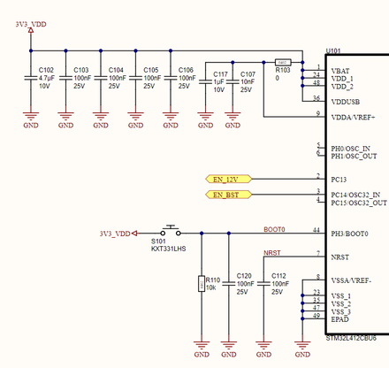

I'm using STM32L412CBU6 and powering from LDO 3.3Volt as attached and no VCAP in this case.
