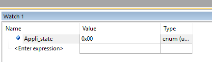

Hi mass storage is being implemented.
Nucleo-F207G is being tested.
en.stm32cubef2 \ STM32Cube_FW_F2_V1.7.0 \ Projects \ STM32F207ZG-Nucleo \ Applications \ FatFs \ FatFs_USBDisk
The sample is usb-detectable without any problem, and the txt file can be written well.

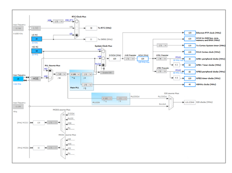

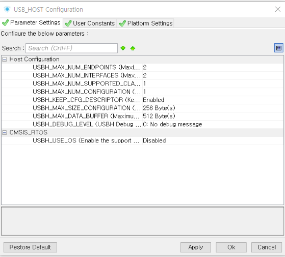

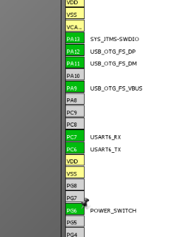

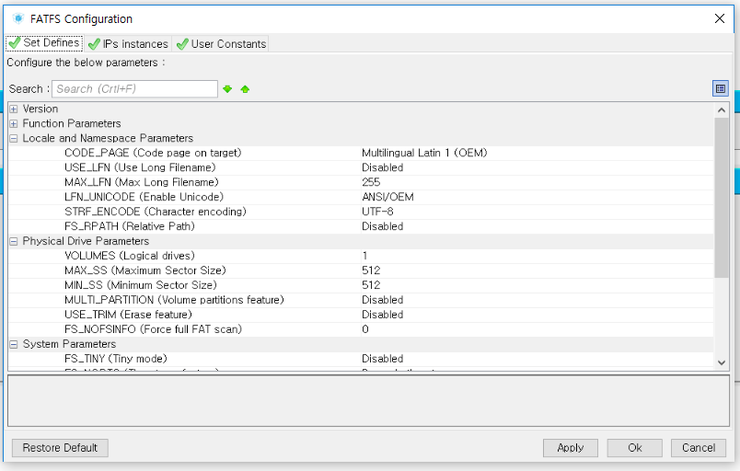

If you design code with cube as below, you can not detect usb.
0690X00000608wWQAQ.png0690X00000608suQAA.png0690X00000608wlQAA.png0690X00000608wUQAQ.png0690X00000608wvQAA.png0690X00000608tOQAQ.png0690X00000608x0QAA.png

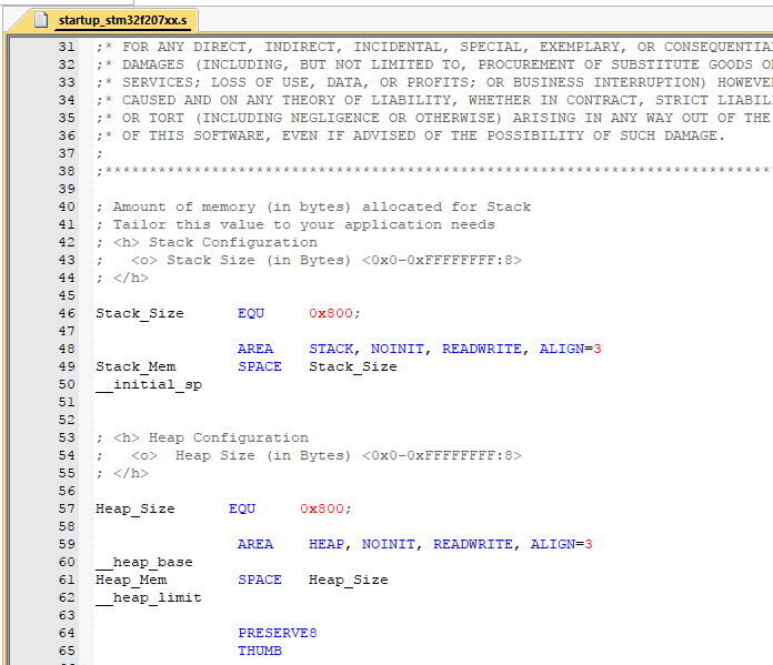

If you create a project with cube, you have to change heap / stack size.

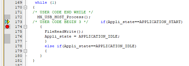

Appli_State value should be recognized as 1, even if you connect usb stick, it is still 0;
I need to solve the problem, but I do not have enough time.
Below is main.c / usb_host.c source.
Have a great weekend!
main.c

  /* USER CODE BEGIN 3 */     if(Appli_state==APPLICATION_START)
       FileReadWrite();
       Appli_state = APPLICATION_IDLE;
       else if(Appli_state==APPLICATION_IDLE)
usb_host.c
void MX_USB_HOST_Init(void)
  USBH_Init(&hUsbHostFS, USBH_UserProcess, HOST_FS);
  USBH_RegisterClass(&hUsbHostFS, USBH_MSC_CLASS);
  USBH_Start(&hUsbHostFS);
static void USBH_UserProcess  (USBH_HandleTypeDef *phost, uint8_t id)
  switch(id)
  case HOST_USER_SELECT_CONFIGURATION:
  break;
  case HOST_USER_DISCONNECTION:
  f_mount(NULL, (TCHAR const*)'''', 0);
  break;
  case HOST_USER_CLASS_ACTIVE:
  Appli_state = APPLICATION_START;
  break;
  case HOST_USER_CONNECTION:
  break;
  default:
  break;
  /* USER CODE END 2 */
