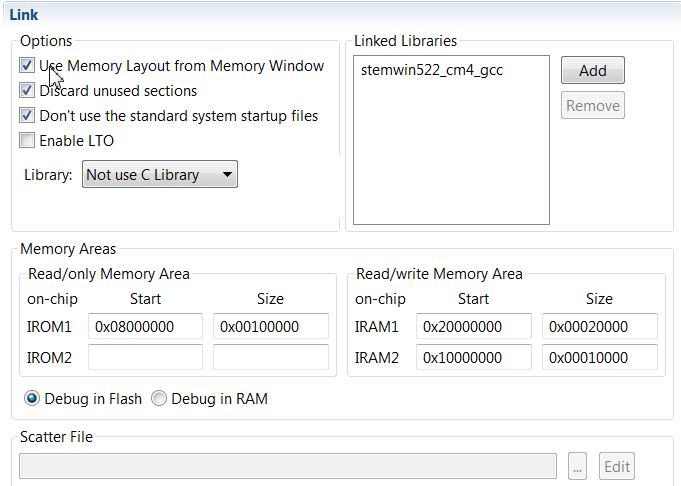

I have successfully compiled and linked my stemWin project: Note that in coIDE I have set the compiler settings for FPU to ?FPU Hard?:
GCC HOME: C:\CooCox\GNU Tools ARM Embedded\4.7 2013q3\bin

I have five excellent new books on embedded systems. However at this time I am ignorant about memory. ?
the linker script and the placement of data in the external RAM? The word ?external? has caused my 72 year old brain to sunder. I am using a ST32F407VG discovery board (only) with a DM-LCD35RT screen with a display controller SSD2119 (standard add-on to embest base board). I do not have a arm-gcc-link.ld file as I have:
