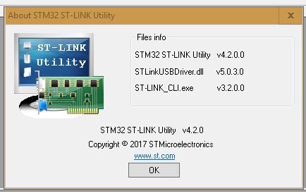

Please check if you have the latest ST-LINK Utility. The ST-LINK you have (seen on the video) is v2, not v2-1?

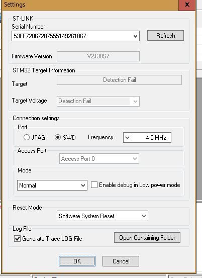

I have link V2, which is also updated to the newest version. Here are 2 pictures.

Attach the log - the messages you see just after starting the ST-LINK utility. You will versions of the firmware there, and ST-LINK HW version (I mean the chines device you connected)
