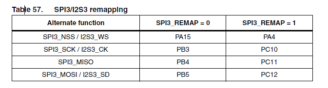

However I can't see any clock signal in PB3 pin when I start sending ff value with SPI_I2S_SendData(SPI3, 0xff); function.
in STM32cubemx something is more strange:
According to datasheet we understand that for SPI3 without any remap PORT B can play SPI role.
However in STM32cubemx when I enable SPI3 and see it's configuration it just enables port c SPI section and it doesn't config anything such as remap.In addition when I change SPI3 for Port B it only change clock source.

Perhaps the Remap code is elsewhere, like where it actually configures the pins, or the SPI peripheral.
