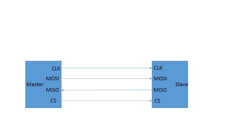

My application is as described in the schematic below :
I want to make an application that consists of :
- The Master sends a command to the Slave , then a data
- The Master sends continuously different commands, The Slave process the command then send response depending the received command to the Master.
The Updating frequency is about 20Khz.
I tried to make this application with SPI interruption but I faced some problems in the Master side to receive data sent by the Slave.
I want to make it using DMA, but I don't know how to go.
I wonder if someone had already made this kind of application because i really need help to make progress.
Thanks in advance,
Note: The CS is handled by interruption where the SPI reception is activated in low edge
Posted on June 15, 2014 at 22:17
If the latency of setting up the DMA in the EXTI is too high, would suggest you deliver the first byte(s) to the SPI manually, and set the DMA up for the subsequent bytes.
