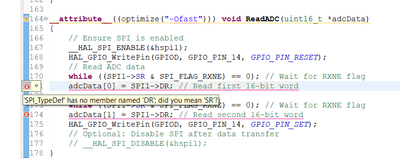

I'm using stm32h745. same issue I facing about spi timing. I want to read adc ads7046 this 12bit adc. I used different methods HAL_SPI_Receive(&hspi1, (uint8_t*)&ADC_Value1, 1, HAL_MAX_DELAY);
HAL_SPI_Receive_IT(&hspi1, (uint8_t*)&ADC_Value1, 1);
HAL_SPI_Receive_DMA(&hspi1, (uint8_t*)&ADC_Value1, 1);
But spi is much slow. for polling it taking 5uS when controller clock 400mhz. and is bigger for IT, DMA...

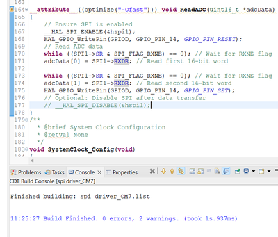

So as your post i want to read direst data register. but i got folloeing errors.
So instead of DR i used RXDR then error solve but output not getting . sclk and cs also not generated means code block at while (( spi1--> sr  line no.170. if i comment line170 to 174 then sclk generated properly
I used setting in stm32cubeide about pin declaration and mode setting, presclare clock and used code generated by stm32cube code generator. so please can you help me where i wrong. i want receive only master.
I need to set pins, mode, clock , presclare all also with register?    Please any example code you have then please can you

__attribute__((optimize("-Ofast"))) void ReadADC(uint16_t *adcData)
    // Ensure SPI is enabled
    __HAL_SPI_ENABLE(&hspi1);
    HAL_GPIO_WritePin(GPIOD, GPIO_PIN_14, GPIO_PIN_RESET);
    // Read ADC data
    while ((SPI1->SR & SPI_FLAG_RXNE) == 0); // Wait for RXNE flag
    adcData[0] = SPI1->RXDR; // Read first 16-bit word
    adcData[1] = SPI1->RXDR; // Read second 16-bit word
    HAL_GPIO_WritePin(GPIOD, GPIO_PIN_14, GPIO_PIN_SET);
    // Optional: Disable SPI after data transfer
    // __HAL_SPI_DISABLE(&hspi1);
  /*Configure GPIO pin : PD14 */
  GPIO_InitStruct.Pin = GPIO_PIN_14;
  GPIO_InitStruct.Speed = GPIO_SPEED_FREQ_VERY_HIGH;
  HAL_GPIO_Init(GPIOD, &GPIO_InitStruct);
/* USER CODE BEGIN MX_GPIO_Init_2 */
/* USER CODE END MX_GPIO_Init_2 */
/* USER CODE BEGIN 4 */
PUTCHAR_PROTOTYPE
	/* Place your implementation of fputc here */
	/* e.g. write a character to the EVAL_COM1 and Loop until the end of transmission */
	HAL_UART_Transmit(&huart3, (uint8_t *)&ch, 1, 0xFFFF);
	return ch;
/* USER CODE END 4 */
