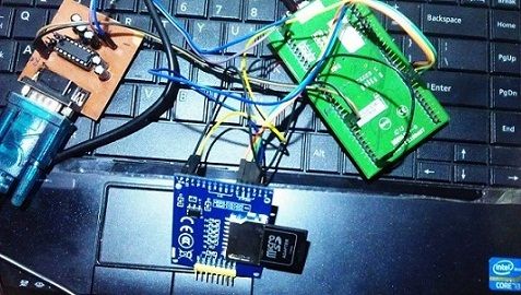

I connected MOSI pin to MISO by wire the configure following code then the system is working. My next experiment is connect the SD card to MCU Any advice

I connected my SPI program to SD card (4GB Micro SD card inserted to big SD card socket )
while (SPI_I2S_GetFlagStatus(SPI1, SPI_I2S_FLAG_TXE) == RESET);
SPI_I2S_SendData16(SPI1,0x44);
while (SPI_I2S_GetFlagStatus(SPI1, SPI_I2S_FLAG_RXNE) == RESET);
temp = SPI_I2S_ReceiveData16(SPI1);
After sending data as above program ( sent data is 0x44) then I read the sd card using hex editor but hex editor does not show anything Please advice, Am I on correct track???
Posted on January 11, 2015 at 15:23
After sending data as above program ( sent data is 0x44) then I read the sd card using hex editor but hex editor does not show anything. Please advice, Am I on correct track???
The protocol for writing to blocks of data on the SD Card is significantly more complication than that.
http://wiki.seabright.co.nz/wiki/SdCardProtocol.html
http://alumni.cs.ucr.edu/~amitra/sdcard/Additional/sdcard_appnote_foust.pdf

Posted on January 11, 2015 at 15:36
pic_micro
Posted on January 11, 2015 at 17:20
Dear Sir.
I found following youtube link how write to the SD card
https://www.youtube.com/watch?v=r9BafZi6Vpc
I can use above method write to the SD card
If Writing part such complicate, Can I have the advice for reading part using MCU
Thanks in advance
