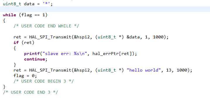

I am trying to communicate spi master and slave with two discovery boards
In my case stm32l152rc is master and stm32f407vg is slave..
When i am sending from master to slave it's receive complete data but when am sending slave to master data it's recived but only 1st byte only in my buffer.
when i am debug slave code at that time slave completely put all data in to DR resister and when master not enble it's clock it's show timeout,too so there is problem whit master side or slave side i cant identify...0690X000006CudlQAC.png0690X000006CudgQAC.png

If the bitrate is high, polling-based transmit in slave may be too slow to be able to store new data in DR in timely manner. You may need to use DMA, or decrease bitrate significantly.

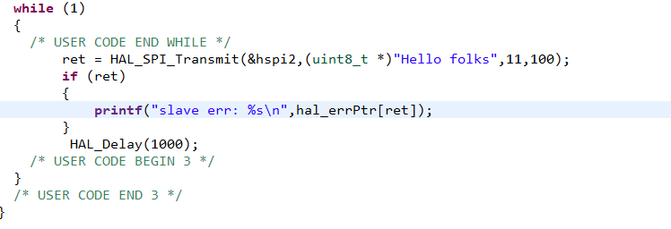

Hi JW,
Thanks for your reply, I am using stm32 l152rc as master with 125KHZ frequency of SPI and I am using interrupt in my slave stm32f407ve but not get the proper output. Even I am trying to make f4 as master and l1 as a slave but facing same problem.

Check if the respective GPIO pins are set properly. How do you manage NSS in the slave?
jkuma
Hi JW,
i am using software NSS in slave and master to slave transmit work properly but when I am trying slave to master at that time facing this problem
I am also try to use DMA but not working
I took software NSS. So its 3 wire communication.

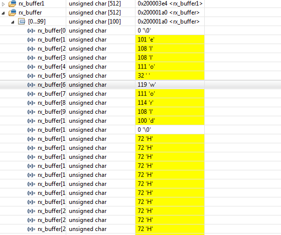

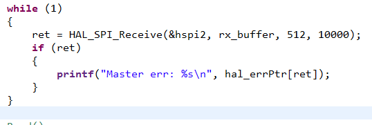

Thanks for your reply as per your advised I tried with NSS with hardware configuration and I archived next step, I still facing problem in master side,
Here I attached some screen shorts can you please help me to solve this problem?
And i have doubt why i received 1st byte in last and received it n times?0690X000006Cv4wQAC.png
code flow....
received buffer data...
