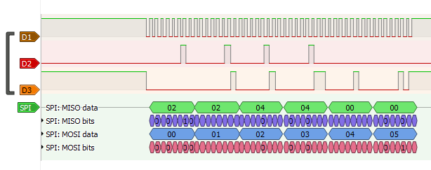

Ole Thomsen
You are right, the swap is pointless and it is true that there is a delay of one byte, but that is not exactly my problem. The second byte that the slave sends should be the first of the master, but it's different.
Ole Thomsen
I tested it with a slave that should transfer a 5-byte array from the master. The slave sends data that are not shifted by one byte, but wrong values.0690X000009jC38QAE.png

Well, actually except on H7's SPI, the assumption of having a single shift register with bit in and out in the STM32 may not be right.
Some drawings show one incoming shift register, and one outgoing different shift register. No HW link between in and out.
The workaround that works for me is to set (for slaves) the DMA to have a cyclic buffer of say 64 bytes. DMA will write and read in this buffer (same one used for Rx and Tx channel). This will emulate by HW a 64 bytes long shift register for the SPI slave which is much more convenient to shift data around in a single round transaction with all slaves. Works like a charm on STM32L4 family (SPI with 32 bit FIFOs) with 1 master and up to 12 slaves.

 Fill the buffer with what you want to send before the NSS falling edge
Read the buffer after NSS rising edge.
Payload is here fixed to 64 bytes (to avoid reaching the insane SW complexity limit).
