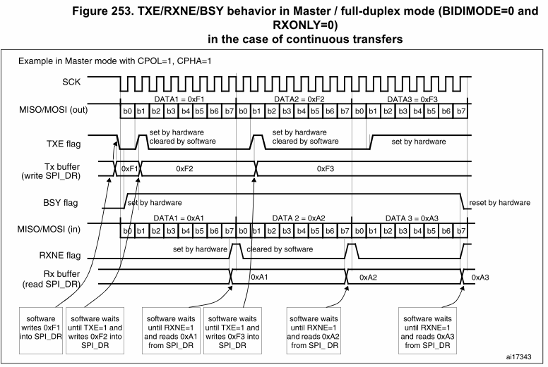

I use the STM32F4 uP to control peripheral IC by SPI protocol.
And I composed the source code according to the the reference manual (Doc ID 018909 Rev 5). However, the data is invalid after SPI_I2S_FLAG_RXNE asserted. The data is valid after more than 1us.
By a scope, the peripheral IC sends the data correctly.
It seem not accordant with the the figure as the following.
Would you help me to figure out how to access the SPI correctly?

2. SPI Read
          GPIO_ResetBits(GPIOB, SPI_CS_PIN);
          while (SPI_I2S_GetFlagStatus(SPI2, SPI_I2S_FLAG_TXE) == RESET);
          SPI_I2S_SendData(SPI2, reg_addr | 0x80);
          for (n1=0; n1<reg_num; n1++ )
            SPI_I2S_SendData(SPI2, 0x00);
            while (SPI_I2S_GetFlagStatus(SPI2, SPI_I2S_FLAG_RXNE) == RESET);
            reg_rdata[n1] = SPI_I2S_ReceiveData(SPI2);
          GPIO_SetBits(GPIOB, SPI_CS_PIN);

Try with this
SPI Read
GPIO_ResetBits(GPIOB, SPI_CS_PIN); // repeat CS select if you want add delay before start read
// here CS ok
n1 = 0 ;
while (n1 < reg_num)
if (SPI_I2S_GetFlagStatus(SPI2, SPI_I2S_FLAG_TXE) != RESET)
if (SPI_I2S_GetFlagStatus(SPI2, SPI_I2S_FLAG_RXNE) != RESET)
reg_rdata[n1++] = SPI_I2S_ReceiveData(SPI2);
