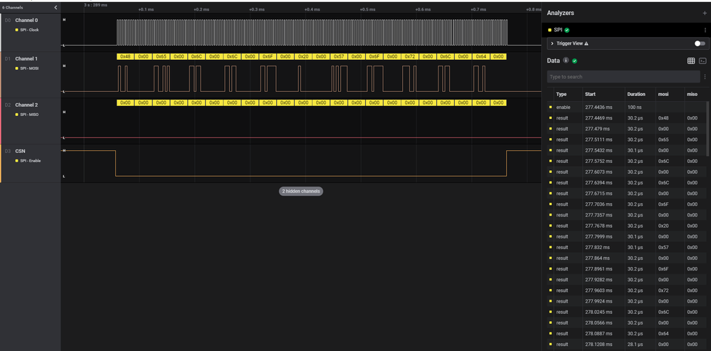

I configured my spi to have a datasize of 8bits. However, its sending an extra '\0' after every letter and i can't figure out where this is coming from. Am running a Nucleo-F303k8.
Here below, am trying to send a Hello World! message but it gets corrupted all the way.
0693W00000BbzC1QAJ.pngHere is how i configured my settings.

SPI-> DR is sensible to write size. Try:
* ((__IO uint8_t *) & pSpi->DR) = (uint8_t) data [i] ;

It seems to be adding 0x00 after every character sent.
