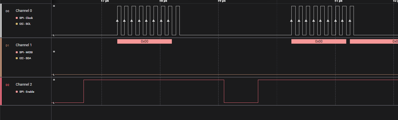

The original driver is only working with raspberry pi, I try to import it into my custom STM32 MCU board, the CLK and CS signals seem okay,  Only the MOSI signal is always low. it seems no data is really sent to the display.
here is the signal capture from logic analyzer.

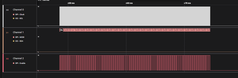

The whole write sequence:
zoom in, single byte write:
what could be the reason? Thanks in advance.

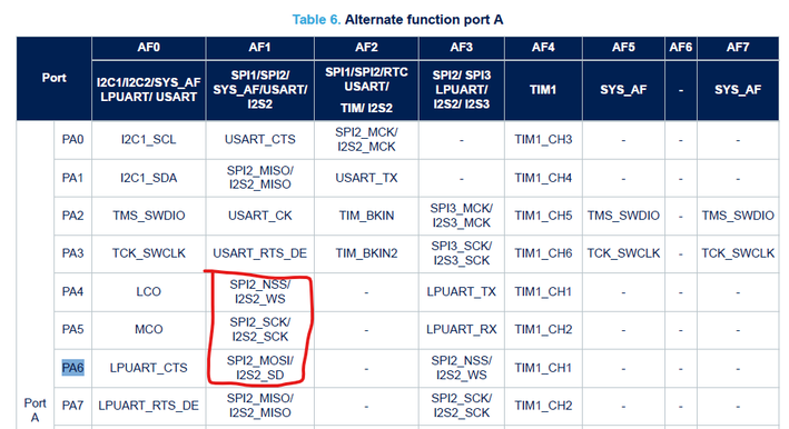

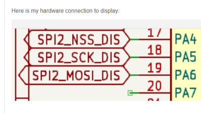

         the master part is BlueNRG-LP, these 3pins are used as SPI2 and PA6 is MOSI.

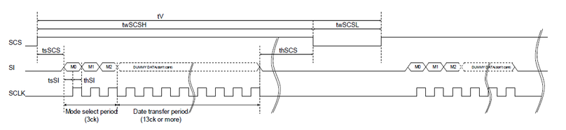

OK, I assume you use a SHARP LCD module, like this:
|LS013B7DH03_datasheet.pdf (sparkfun.com)
OK, it has an SCS signal (not an NCS or NSS signal, just to be "picky"). Yes, this is high active in this datasheet.
The call it "Chip Select Signal" but use SCS (maybe a typo and it should be CSS).

  • PA6 is MOSI - OK
  • PA6 toggles (in GPIO mode or in SPI mode?)

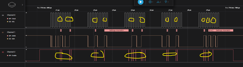

regardless of the complex display data format, now I just try to write some simple data on SPI like this:
  uint8_t data[5] = {0x11,0x22,0x33,0x44,0x55};
  BSP_SPI2_Init();
  LL_mDelay(10);
  while(1){
    BSP_SPI2_Write(data, 5);
    LL_mDelay(1);
 even without display:
the CS pin during the write cycle unexpect goes down and it causes wrong transformation.
