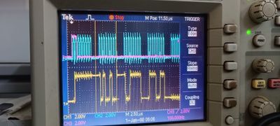

I have successfully interfaced CS5532 with ESP32
The updated code is attached for reference.
When I interfaced CS5532 with another microcontroller(ESP32), I got the output properly as shown in ESP32 (Expected) image (Second image).
Yellow line : MISO data
Blue Line: Clock 2MHZ
Pink line: MOSI data (0xC0)

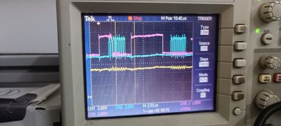

But when I interfaced it with STM32 I didn't receive any signal.
The clock pulse is having set of 8 cycles (8 bit data). So while interfacing with STM32 the MOSI signal goes to high between two sets of clock pulses.

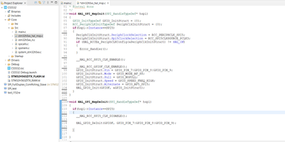

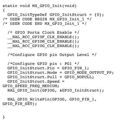

1) in the code I do not see SPI5 GPIO configuration: MOSI, MISO , SCK pins in Alternate functions or I overlooked the code .
 There are only clock enable if 3 ports F,H and G and configuration of PG1 ( CS) in software and No PF7-9
2) try another SPI port for debugging purposes and using our reference code examples .

These functions are included in stm32h5xx_hal_msp.c file which is generated by stm32cube.
I have also tried it with spi3 and spi1 and facing the same issue
