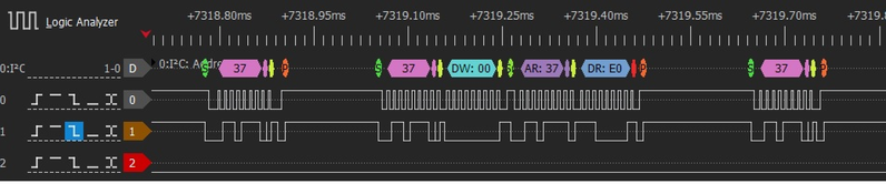

My problem is i require emulate with STM I2C chip , that requires wake adr send before comm. But normal slave code isnt handle this.
Signals on bus (FYI master is other device no STM)
as can see master send one adr without data and repeat, first reply is ok, but next reply is always E0 what is fault
semantic my code based on example IT slave receive from HAL. Can somebody help handle this.

That first single-byte transaction might not be a "wakeup" but rather a normal "see if that device is ready to respond" query.  All it does is see if the slave device "ACKs" its address.
What? I don't see two replies.  I see an address then a WRITE byte value 0x00, then a repeat-start, address and READ byte of 0xE0.  Then I see another "is this device ready" transaction with just the address byte.
Is that not what you are expecting?
If not, as always on this forum, post your actual code (using the code formatting button that looks like "</>", click on the "..." to see it).  This helps us help you.
Bob S
Hmmm, maybe I mis-interpreted.  Is that I2C sequence showing the behavior of the device that you need to emulate?  And you are having trouble providing the same response?
The HAL I2C code should handle the "is this device ready" sequences, though I don't recall exactly how.  The HAL receive call may return with an error code, or it may return with a data length of zero.  The answer is still "post your code".

here may code that react to master and next DW you dont have on image is 97 reply required is 03, but this code reply E0

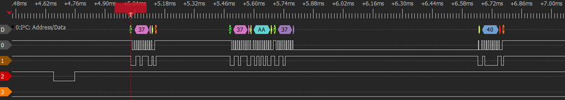

Ofcourse real IC wake and master send 3 ping with addr for this. Two is NACK.
I change code to

now it relative works , but reply is delayd Howto solve ? I mean no HAL is required here.

Some of that delay is the HAL functions and your code responding to the other device's read request.  Though 1ms delay seems a bit much even for HAL.  It has been a while since I've done I2C slave code so I'm not sure I remember all the needed steps.  You code does look similar to some of the Cube example code.
What is your CPU's clock rate?
